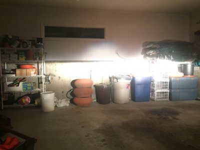

She just came home, stopped in front of the garage, came inside to get me so I could see the headlight reflection on the backend of the garage...
What common sense challenged engineer then common sense challenged marketing person then common sense challenged executive could have conceivably thought a projected headlight of the type installed on the '18 XLT is anything but dangerous. We live in the mountains. Good luck picking out deer alongside the road and farther up ahead using standard beam (assuming not high beam for several good reasons/conditions)!?

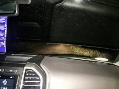

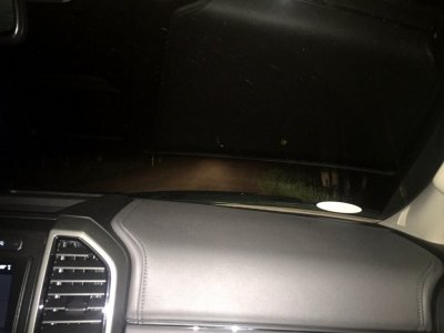

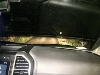

Below are the images. that little sliver of light through the windshield is the low beam while driving up a mild incline on a road without street lights.

Wow, so I have a platinum which means I have the LED lights not the ones you do, but that is certainly not what mine look like (especially the low beams), nor is it acceptable. I agree with your dissatisfaction. I am really interested to hear if other XLT owners on here (or Limited owners without the LED lights) have the same light situation.

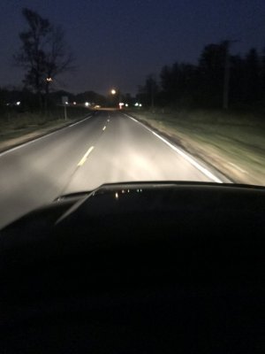

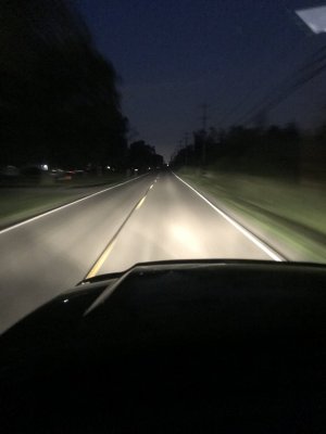

Here are my stock halogens on my 3rd gen (low beam and fog lights), boy what a difference. Maybe yours are aimed wrong.

I don't get it. Even if our's are aimed wrong, where's your 'sharp, horizontal cutoff line? Yours look perfectly fine. Is your Expedition a 2018?
