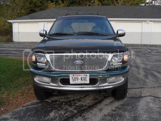

I have those lights as shown and so far I love them. However (Keep in mine I did the grille too) I had a very hard time putting them in and having to push till something breaks. I ended up breaking the passenger side housing in 2 spots that I had to Epoxy and then seal with clear silicone. It is fine now but I just thought I would put it out there.
