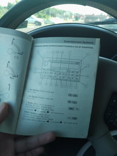

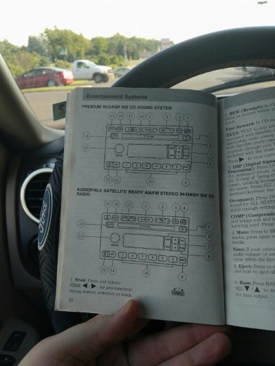

Okay, so here's the two pages in my manual! I found out something interesting- the radio that ebay keeps pulling up, with the single cd/cassette player, that my old 98 explorer had, is NOT the CD/Cassette player in the manual! So perhaps I just need to find THAT one and then I can try that out...

Okay, two updates!
Good news:
I found the Headunit that just has cassette and CD, it's NOT the old one from my explorer, it's the same style as the 6 CD changer!
