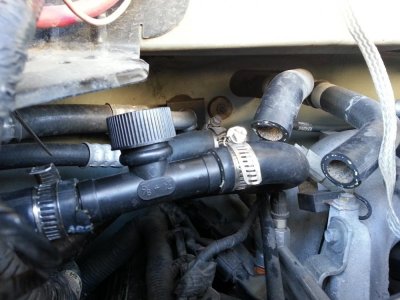

Ok so as a temporary solution I cut the inlet and outlet hoses and coupled them together with a radiator flush kit 'T'. After a couple weeks there is no coolant/exhaust smell in the cabin and my windows are not fogging up nearly as bad. Still a few more weeks until the weather warms up enough to take on the full project but I will update with pictures and results.
Right now I am planning on doing the following during the heater core repair:
1. Replace both front and rear heater cores
3. I will either couple the inlet and outlet hoses or completely replace based on price. (I've heard they can get expensive)
2. While the dash is out I will also solder the diode on the back of the gauge cluster as I am having the common mileage display fade.
