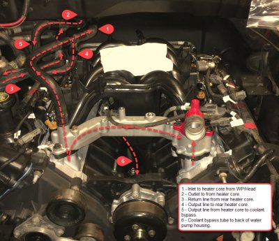

I believe this is a correct coolant flow diagram. In theory the front and rear shouldn't affect each other because of the T's in the cooling lines.
