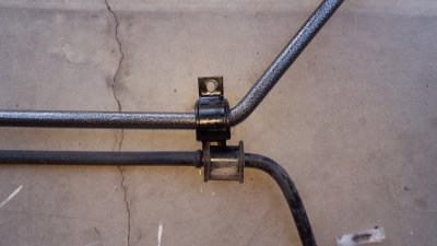

Has anyone else purchased this sway bar? Was your install successful?

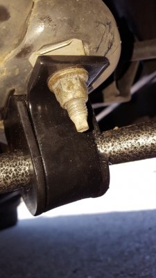

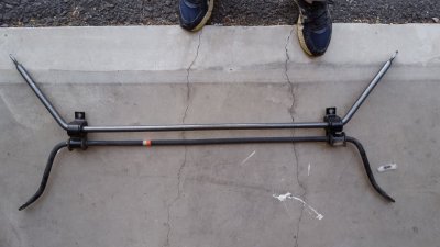

I'm currently working with Hellwig support. As of now, it is not fitting the truck. It's like the long straight part needs to be about 1/2" to 1" longer. The bends are landing within the bushings. If you look at the pics, I aligned the left side brackets and the right side brackets are not nearly aligned.

Sounds like they sent the wrong part! If it doesn't match up with the old one, send it back!

Hellwig sway bar (And probably other brands sway bars as well) is vehicle specific and options specific. You need to check if your truck came with factory end links or without, if you have trailer package (19mm sway bar) or without, Auto adjusting suspension - 18mm sway bar or without auto adjusting suspension - 21mm sway bar.
with that, as previous posters said, the shape of the sway bar would change as well.
Best to return or exchange with the correct sway bar.

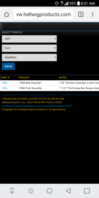

Looks like only 1 option available for the rear from hellwig

I have trailer package, without auto-level, with end links. Hellwig only lists one part number for 2016 rear sway bar. I'm trying to work with their support to figure this out.

Does hellwig use their own size or is it supposed to be the same size as your original?
If same, then look up bushing sizes for the '16... with trailer, without level should probably be the 19mm one (21mm is the one with level, without trailer package)

Their bar is 7/8" and comes with its own bushings and brackets. My problem is the bracket bolts are fixed to the frame and not wide enough by about an inch.
Maybe they sent you one for an entirely different vehicle?
These things happen more often than you think

@MuddySpokes I gave up. They sent a 2nd bar and it's exactly the same as the first one they sent. I had fallen off a ladder and broke my arm around that time too, so I couldn't even try it for a few months, but it didn't fit either.
