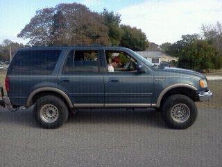

Dude, looks good! I was thinking it would be a tighter fit but not bad.
2.5” front and 2”rear.....Its hard to tell in your photos due to angle but is she level from front to rear? Or sitting low in the rear?
You kept the stock spacer...does the stock fit into the aftermarket spacer? Is it cut to match?

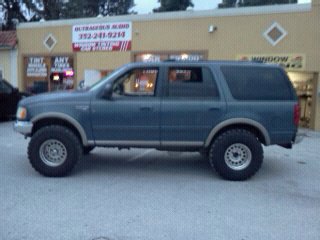

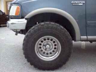

it is sittin level. i took off my front flares today instead of cuttin them and eliminated my rubbing. the stock spacer will fit into the whole if u want a full 2" lift keep it in. i got 1.75" cause i took it out. i measured after the truck was done and wasnt takin it all back apart for .25" difference. but u can keep it in.

looks good. hard to believe you tucked those 35's under there with some 16x10's. that was the setup i had on my expy with a 4" susp lift and i still rubbed!

Thank u lane and nvy. I drove around today and realized that I ru my right inner well. Ecer so lightly. Only that side tho.there's like a little bubble on that side and I'm hittin it. Other than that I like it. I'm designin a bumper now. Next is a 2" BL, 315/75R16 BFGoodrich KM2s on 16 x10 rockkrawler imitation beadlok. After that SUPER DUTY axles wit 38.5x15.50R 20s
