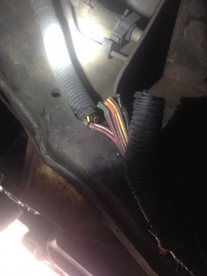

2000 expedition 5.4 2we someone cutt a set of wires that runs along the outside of the frame rail just below the driver door. I've wired the wires back but only fixed a few issues like fuel gauge is now working again. It was throwing a lot of codes before only a few went away. An od light still flashing ! Any help ?? Any1 know what all those wires work ?

All the codes are circuit codes. I need to know what that set of wires goto.
Before i found the cut wires
My gas gaauge wasnt working an it threw all these codes.

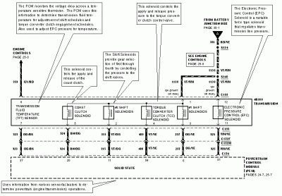

P0155 is o2 sensor bank2 sensor 1 an p1409 os egr vaccum regulator solinoid circuit, is that what transmission thats in mine 4r100 ???
