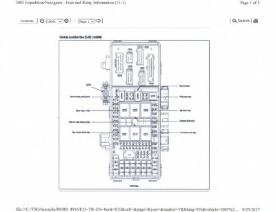

Okay no burnt fuses all the fuses are good so in the pictures where are these wires located at near the fuse box or someplace else?
Bedrck47
Jul 4, 2014
5,639
659
Elizebethtown, PA
They are on the fuse box Two different connectors they are side by side
Look at the pictures You should be able to figure it out
I believe the connectors are either above or below the fuses Can't remember which
The green wire with yellow stripe is in a 4 wire connector
to the solid red wire. It' in a larger connector just to the left of the 4wire connector

Look at the attached pic Look at the top of the pic you will see C270a and C270k those are the two connector that you will use the jumper in
