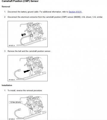

Could be Camshaft sensor or Crankshaft sensor but should throw a code.

Crank position sensor will cause some jumping/humping but not sure how to test besides replacing and saving old one for later if good.
Does tach move while cranking/trying to start?

The sensors are not that expensive. Yours and mine do not have the problems with tensioners like the 2008 link. May be a broken rocker, etc under a valve cover. As stated earlier, 145k is not that many miles especially if proper maintenance was performed. You could get out of this cheaper than you think. Check under the covers before you throw any parts at it.
