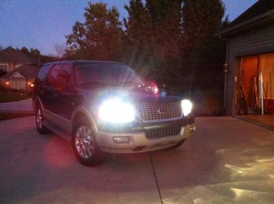

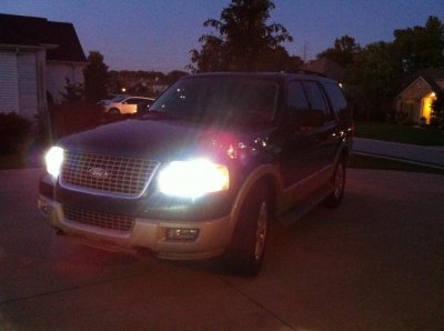

Here is my 13 with 6,000K bulbs and 35 watt ballasts. I would shy away from 8K unless you want to look like a ricer. My friend has 8,000 on his Cobra and is waiting on his 6,000Ks to get here after seeing mine and the difference at night and in the rain.
