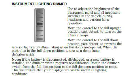

I have a 2013 Expy. I need to somehow activate the instrument cluster lights during daytime without the headlights or parking lights on. Is this something FORScan can do? Can I do this myself with aftermarket software? I have a laptop with WIN10 and an Android tablet. Also can FORScan do cylinder power balance check?
There should be a vertical dial to the left of the steering wheel and almost behind it, on the vertical panel, that controls the brightness of the dash lights, including turning them on or off. If you turn it "up" they should turn on and you can control the brightness. If that dial doesn't work check the fuse and if that is good you probably have a wiring issue or blown lights.
That dial does everything one might expect it to do, but it does not illuminate the cluster unless the headlamps or parking lights are turned on. The owners manual suggests the same. Do yours work differently?
