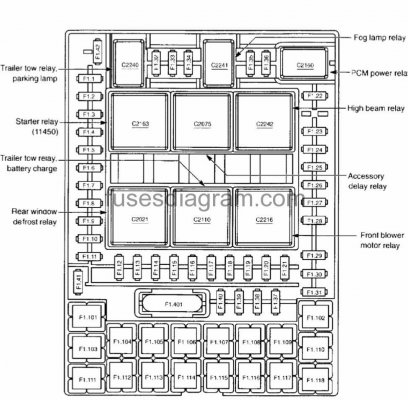

If it's only happening when you use the turn signals that would point to the multi function switch that is the turn signal stalk / high beam stalk . Instead of disconnecting the battery you can pull the high beam relay there in the fuse box. You can also try swapping the high beam relay with one of the others there in the fuse box, but I tend to believe the issue is the steering column multifunction switch.

I ordered a new turn signal switch since it's broke and I pulled the #35 fuse to stop lights being on... hopefully once I change the switch and put fuse back in things will be straight
