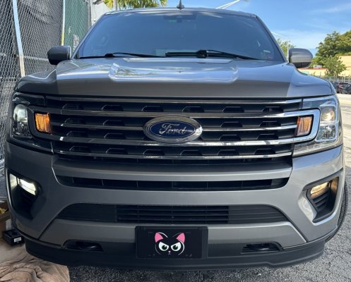

I just went through this today, with lights ordered from Morimoto.... I ordered headlights with the anti-flicker boxes, and fog-lights without .... When it all got here, I noted that they had the part numbers reversed... The 9005s are the correct bulb for low beam (and if using the Morimotos, you will want an extended boot as well), the H8 fit the fogs.
At present I have flicker on the low beams, as they lack the box. As I recall Forscan has a LED mode option, so I will try that, but might end up needing the boxes... A little annoyed about the cross reference error on their site, but know we will get through it... There is a definite difference in light between the halogens and the LEDs.
In this pic the LEDs are installed on the passenger side, while originals remain on drivers side.
