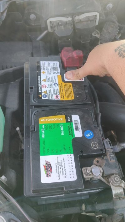

First thing I did to my SPP when I got it. TUrfed the H6 battery and put in an H8. I did nothing programming wise or BMS reset like it was with the 2018 models to my 24 SPP.
Just swap ‘er out and good is. Just make sure the battery is fully charged before you swap them. That’s it. I think I did supply power to the cables during the battery swap, so it wasn’t loosing anything.

Nothing to worry about changing in between Group H6, H7 and H8 batteries on a Ford as long as you stay with AGM. Some older ECUs have to be adjusted, the newer ones do not! My old F150 3L BabyStroke had an H8 fitted from factory.
