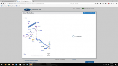

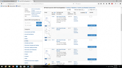

did you price the OEM cooler, ?

Thank you for posting the cost with the illustration.
@bsevans5 thank you for answering my original question.
I did make a big mess when I installed the cooler on the Odyssey. Fluid on me, various places in the engine bay and the street. Messy but the temperature gauge didn't budge at low speeds in Arizona at 6,000 plus elevation. I want to get to that point with the Expedition.
