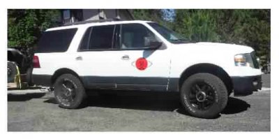

Stock, my 2011 was a dog because of high centering. I travel remote desert locations for work, and if I can't drive, then I have to walk. About 10,000 miles ago I lifted 2" with some coil spring spacers and put 33.5 tires on (Hercules 10 ply), plus a skid plate. WOW, what a difference.Copy of Expe 2011.jpg
