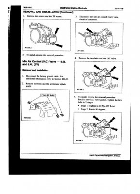

The IAC is on top of the throttle body it has 2 bolt and a wire connection plug. I hope this is what you are looking for. You clean it with carburator cleaner, they just get carbon up, I clean mine and it went about a year before I decide to replaced it. It costs $144.00 at the dealership I got it at NAPA for about $85.00 for the 4.6l which is higher for some reason, the 5.4l is around $55.00. The part number for the 4.6l is napa 2-16790 valve. Good Luck
