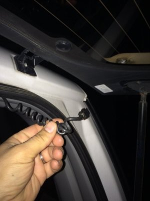

I tried to solder weld it but that failed misribly, can I crazy glue it? I don't think crazy glue is conductive so...
Also anyone knows the part number for the clip that mounts to the window itself? I now misplaced mine and gonna need a new one.

That could be a great resource if it works. I had the rear defrost tab pop off on my old Crown Vic and I couldn't find a product that worked. The only other option was to replace the rear window.....needless to say, that tab dangled for a while....

I used the Permatex kit# 21351 last year on my Expy's defroster tabs and I haven't had any issues. I was skeptical about it at first, but worked fine!
