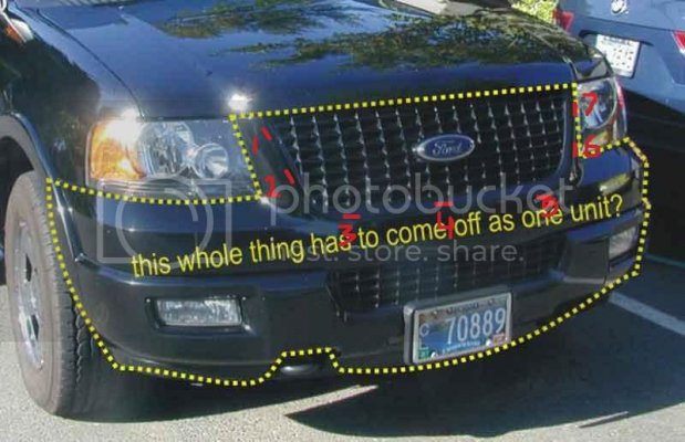

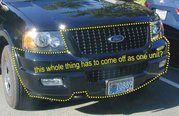

Hi,
I need to remove the front grille in order to mount a PA speaker (which is too big to slip in from the top).
Looks like the plastic grille is attached to the entire (plastic) front bumper cover/spoiler/apron assembly and they will come off as one unit
I can get to and remove all of the screws holding the assembly in except for two spots at the bottom where the assembly has two extensions attached to the chassis. There are two plastic disc-like fastener holding them together (see picture). The "disc" rotates but it does not unscrew, my question is how do you detach these two fasteners? Do I just pry it lose and not have to worry about it breaking? Or do I let it break and get new ones to snap back on later?
Or is it possible just to remove the grille without removing the whole she-bang?
Thanks in advance!
Stewart

Did you mean 04 Expy? If so, the grille is removable. It has like 7 or 8 clips, which you have to pull/slide off. I'll try to take pictures tomorrow, but it is a bit of a PITA to do. Still, I'd assume it's easier than taking off the whole front assembly.
ELVATO
Nov 25, 2006
2,637
30
Orlando, FL
BTW, that round thing is I think to hold the flexible plastic piece on the bottom that seems to act as an air dam. Not sure, though.

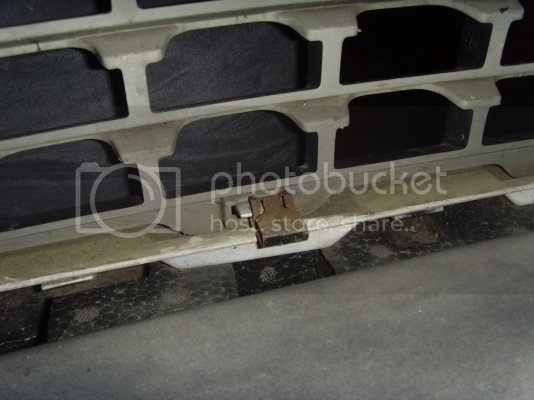

Here's a picture of what one of the clips looks like:
It seems that there's 7 clips total, 2 per vertical side, and 3 along the bottom of the grille. Clips 1 and 7 you will have to feel for to find them. All the rest should be visible.
Sorry for so many posts, I saw you were online, and didn't want you to miss something if I edited.

This is great! Thanks for your help! The clips were not obvious at all! =)
