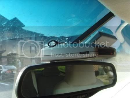

Here's a pic of where I have mine installed. It's an Escort X50.
It's on top of the rear view mirror for two reasons. A) For the best radar reception and B) Since it is resting on the rear view mirror, it is less likely to "bounce" and possibly fall. Also, since it is right below the tint strip, the sun doesn't hit it as badly.
Mine isn't direct wired, though because I take it off whereever I go. Prolonged direct sun exposure is bad for radar detectors (any electronics, really.)

i have the escort x50 too. I thought about placing it above the mirror like you have done, but what did you do with the power adapter that goes to the cigarette lighter, please tell me it doesnt hang down. The coiled cord isnt long enough for me to wire it from the top around the window to the cigarettte lighter, thats the reason i want to hard wire it, with the cord that came with it.

Yep, I'm using the coiled chord that came with it. It reaches. Don't know where the plug is on a 2007, though.
