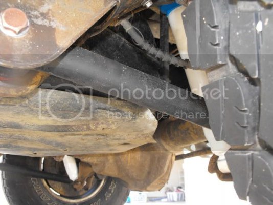

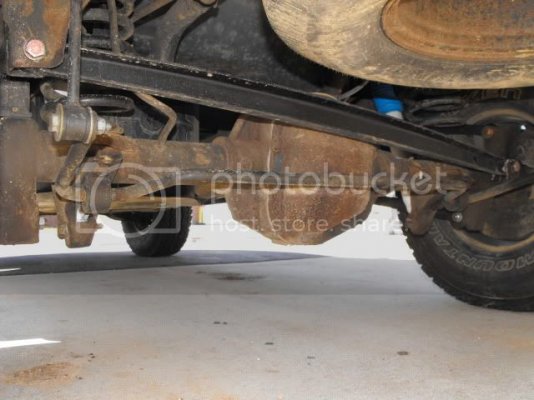

Here are some pics from underneath.
Custom made lower trailing arms, that are so much beefier than the stock parts.
I made a custom track bar but there wasn't enough bend in it to clear the diff so I just refurbished the stocker and put in some poly bushings.

dang **** now i have blue expy competition! lookin fresh really, those old pictures dont do it justice, great job!
99 Expy
Feb 19, 2010
1,016
Laramie, WY
Looking pretty good JD. I replaced all my suspension last summer. I like your new control arms, I should have fabbed some up when I replaced mine.
