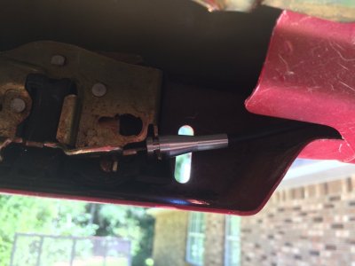

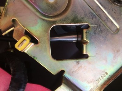

I just bought a 01 Expedition. The rear hatch does not open. I opened the door manually. Door cable is fine. Window cable is broken. Here is where I am lost.
The lever that pulls the door cable does not move when the handle is turned.
The key lock assembly is attached to nothing other than the door. It has a rod that moves up and down, but is not really attached to anything.
I can hear what I think are the locks moving when I cycle the locks, but I don’t see anything moving in the mechanism.
How do I change the window cable? Am I missing parts? This was a family purchase and I am the third owner. I was the first to open the panel. Any suggestions?

Welcome aboard.
Remove the inner beauty panel; you'll have to cut the moisture barrier and use shrink-wrap tape to seal it back up. Trace your cables. You'll probably see pieces of black-like rubber/plastic as you peek around at the bottom of your door. 3 of my 4 ends were completed deteoriated off & the 4th cracked when I wrangled it out. Replacements are machined aluminum.
I HIGHLY suggest your replace both of them, one at a time. They may visually seem o.k., however the ends will rot off leaving you, unfortunately, stranded.
I took the latch mechanism off on mine ('97) to be able to remove the old broken one & reinstall new cable-much easier. Tight quarters inside.
Ordered @ https://www.ebay.com/itm/221754934910?ViewItem=&item=221754934910
Thanks & Report your resolve.
