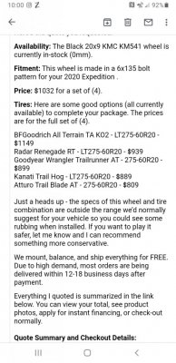

I'm struggling with what tires to get. One guy at a tire shop suggested federal rts 33", but the guy from Mrwheeldeal said 33" will cause it to rub even with the lift.
I really like the set up with the tires poking out some. I'll post the recommendations from Mrwheeldeal. Please help me!!!!!
*I'm not looking for off roading tires, I drive highway and interstate quite a bit, I just want the more agressive look. Screenshot_20210311-142952_Chrome.jpg Screenshot_20210310-100050_Gmail.jpg

They can generally pull your sensors off your factory wheels but if you’re buying them mounted and balanced already you could just buy new sensors as well. I highly doubt you’ll rub. If it were me I’d buy the BFG or Good Year out of those options.

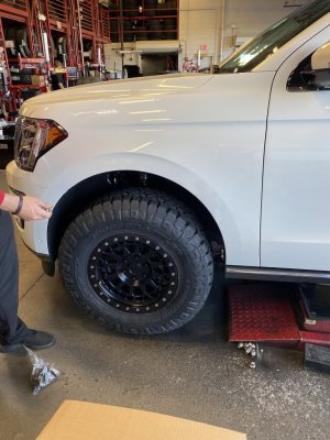

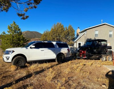

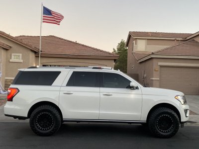

I did 295/70-18 nitto ridge grapplers and the only mod I had to do was pull the felt forward on the front of the wheel well. I went with the 3/2 lift. It was close to the power running boards but cleared so I took them off and cut 3/4” off them and reinstalled the picture with the trailer is after the lift the other two are when I drove it gone from discount tire with the tires on and stock suspension
