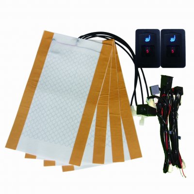

I am however having quite the hard time trying to find a fuse that is only powered by ignition. I checked and all of the ones I want to use, 20A and above and all are powered.
This is what I'm using: 71kuq627zyL._SL1500_.jpg
When the dial is at the 0 position, the number light is off, but the little seat sign is lit blue. This is minimal, yes, but for 2 seats and in a car that will see most of the use during weekends, I fear issues. Or am I being paranoid?
