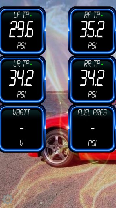

I'm new to torque pro, but found out if you are connected with vehicle running TP will show all the pids. And if they will work for your vehicle, there will be live data there before you add them to your custom dash. If no data dont bother adding them, as they wont work. 0bc1baf9fd48f04ecbfeab9cfbe1bfbc.jpg

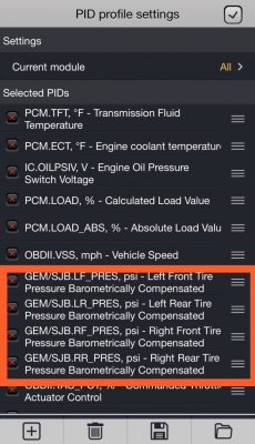

Look in the Network A - Body Control Module PIDS in the Ford, Lincoln, Mercury Extended PID list. I use OBDLink and OBD Fusion. You may have to purchase the extended PIDS, and then allow the app to search after you log in and connect to the OBD system. Make sure your vehicle is running when you do that.

I bought ForScan and up popped the tire pressure readings. Not sure why the extended pids in the other 2 don't have them, but I can get them now if needed.

I used OBDLink and Torque pro and couldn't get the tire pressures. ForScan worked fine on my 2010. It was just like the above pic from Frankin Jones.
