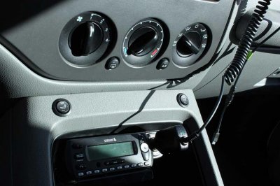

Didn't go too bad. Got power from the trailer charge circuit, because it is a switched 30 amp source that is not used at all or very little. You grab that behind the main power panel at the passenger kick panel. Orange wire on the side of the connector, next to a center orange wire and a brown wire that one goes to the defroster on in the back) Connector c270N.
Used a youtube video on replacing the bottom seat cover to show how to strip the seat apart, *Except* you do not have to take the reclining lever off.
Used these heaters, they were $85 shipped for a pair.
Universal 11" x 19" Carbon Fiber Heating Element Heated Seat Heater Kit
Have to cut out a section on the bottom in the middle for the velcro to attach to the seat foam. While I was there, I replaced the bottom seat foam. Now the used car feels even more new.
Foam from Tasca was about $85 shipped.
Works fantastic so far. Hope they last.
