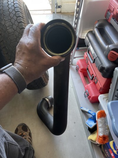

Attached is the O-ring in question, correct? If so, you are more than welcome to it. If you need the charge tube it’s available as well.
Just let me know, and I am more than willing to “donate” it to your cause. If you need the entire charge tube for any reason I’ll let you you have it (and the O-ring) for $60 plus shipping.
There’s nothing wrong with my parts. Just removed for a Full Race upgrade. Charge tube just needs a wipe down.
I’ll be at home until next week. Let me know thru the website, or at [email protected].

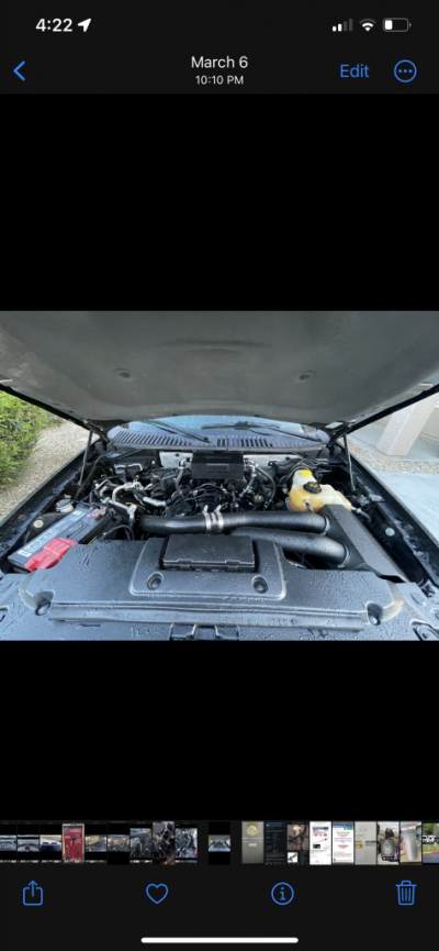

FYI- I’ve got these OEM items as well: intercooler (tapped/ capped for the oil drain mod), and BOV. Aftermarket: Full Race CAI. Didn’t like the increased intake turbulence noise it created. Also, the tune didn’t seem to care for it. Bogged it WAY down. Supposedly, truck was tuned with the air box cover off to simulate CAI installed (CAI hadn’t been received when third round of tuning occurred). So, either he forgot to do what he explained, or he really needed it installed to trusty optimize his setting’s. Either way, it sounds horribly loud IMO with the CAI installed. Didn’t like it.
