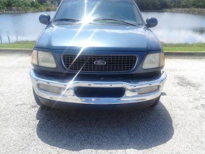

Yours looks identical to mine. Will have to check on the switch. Never tried to pull it out. :)
98EXeb
Apr 26, 2012
167
FL
I have a 98 and this is what my front end looks like minus the bumper trim....lol

That picture is a 99-02 front end. The fog lights would be in the plastic valence below the bumper on those years. Requires a change of the valence to add fogs, there are no cutouts in that valence. Wiring might be there, it was on my truck (99 XLT), fuse and relay were present too I only changed the switch, plugged in the unused connector taped to the harness behind the switch, done.
hwy73
Dec 27, 2010
104
19
South Jersey
Just noticed you have tow hooks. If you do this, you would have to specify a valence for fogs and tow hooks, so all the holes would be there. When these trucks were new, 4 different valences were available dependng on the options. 1. No hooks, no fogs (no holes), 2. hooks but no fogs (what you have), 3. fogs but no hooks, and finally, 4. fogs + hooks (4 holes). I know, crazy, and I wonder if all 4 versions are still available.

the lower optioned trucks w/no fogs got that lower valance. its the same f-150/expedition over those years depending on options..ect

Mine has rear air and third row.
I'm going to be pulling my hooks and transferring the push bar from my 98. I'll just mount some lights on that. I'll see if I can find the wiring.

Mine has that front end and the knob does not pull out. I have a 2000 xlt

sry thermo but ive driven tons of f150s and expeditions and never had a headlight switch that pulls out for a truck with out fogs...
his bumper was probably replaced with the less expensive non foglight bumper

also the bumper might be from an f150 but that doesnt matter because the f150s and expeditions have the same front end :) till 03 that is
just like 250s and excursions
broncos and 150s
