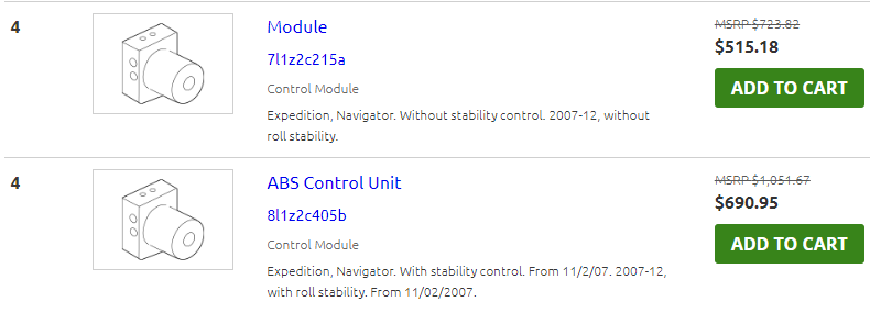

Looking at Tascaparts.com, it appears that both modules (with and without stability control) may still be available. I've also heard that some companies will rebuild your existing unit, but don't have any experience with that.
