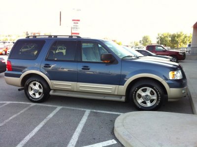

Hi I'm new to the forum. I just purchased a 2005 Eddie Bauer Edition 4WD. as far as I can tell it's loaded. Two troubling issues that I'm having is that the A/C does not come up through the seats and the rear A/C fan comes on but no air blows through the vents in the headliner.
Also is there any way to get a print out of the window sticker for my vehicle? I'd love to know exactly what accessories it has on it. I think I figured out many of them but I can't tell if it has the power folding mirrors - if it does, it doesn't work.
It has 119,000 miles on it and it drives like new. It also has Air suspension and traction control.

That looks exactly like my expy.
