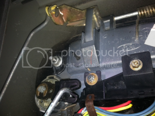

I took a pic of the inside of the door today the best I could
here id the back of the handle
You can see the black thing with the rod in it- that is what the key is turning and that rod goes down the to the latch- the rod above that is what opens the latch when the handle is lifted

Ok, now it makes sense. And I bet I know why the window makes the metallic noise, I'm guessing that lower rod is not connected to the black piece anymore and it's hitting that.
This looks a lot more accessible than I expected it to be, it's not really that wide open, right?
