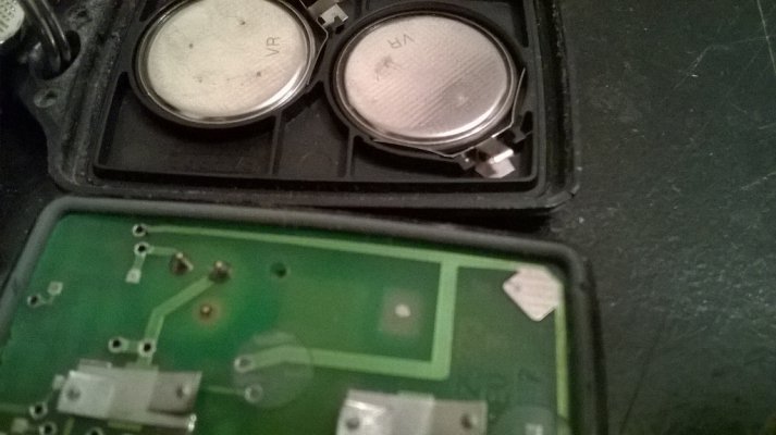

my expy did that before but it uses an older style remote since it is a '97 model. there was no windshield leak when I looked. turned out to be the remote where the batteries make contact.
in the second picture you can see where the battery has a couple of little fingers grasping the battery, I had to bend them so that they had some pretension on the battery to make better contact, I did this with any connector that was made as any kind of spring and the problem has not returned from either remote. and to note, these are ones I bought for $1.50 a piece.
