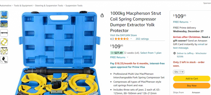

No, never used Quick struts on any vehicle. Just buy replacement Bilsteins and call it a day. You should be able to reused te strut mounts from the old struts and just use a spring compressor.
My son and I used this to change the struts on my 2010 Ford Expedition.
