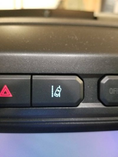

Did you try pressing the button on the dash? Mine was accidentally pushed once and I thought something was wrong as I couldn’t get it to work by going through the cluster screen menu. All I had to do was push the button on the dash to reactivate it.

It worked fine for the first half of the highway trip (vibrated and nudged me back into my lane). I understand it won't activate at lower speeds but a button on the dash? Not sure where it is and what it looks like but I will look at that first thing in the morning. Thank you!
