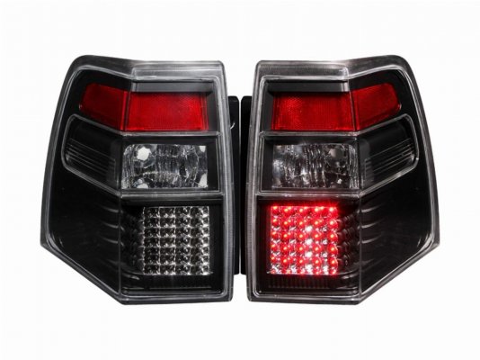

I have the Anzo 311110 for my 2013... works great since 2015. I actually have an extra set.... long story... got some as a gift when I already has purchased a set.

Many parts websites do this, don't know why. I'm fairly certain there is no difference between 07-17. Going further I don't think there is any difference between the 03-17.
Mine are all red, same LED array as above, I just preferred the OEM look. Not show above are 4 side-firing LEDS as a side parking lamp. ExpeditionAndy has the same ones on his 2017, lots of photos of his on this forum somewhere. Kind of disgusting I paid $500 and they are now easy to find for under $150.
You'll reuse (or upgrade) your stock reverse bulb and they come pre-wired with a magical black box that keeps the turn signals flashing at the correct speed and prevents a bulb-out warning message on your dash.
