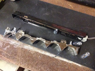

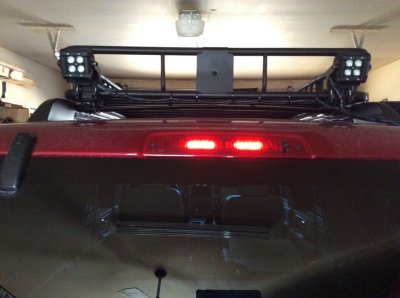

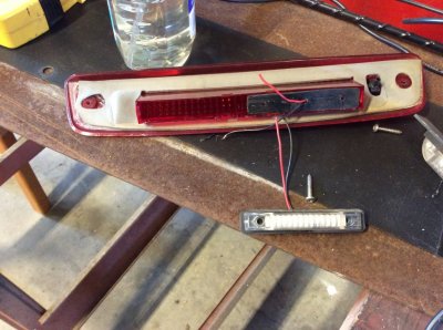

I decided to make my own 3rd brake light instead of buying one, I very pleased on how it turned out !
The lights I used are water proof boat lights I got at Walmart, they fit the housing perfect, the original light assembly popped right out and these two lights popped right in without any cutting or breaking of the housing, I used DIY Auto Tune water proof plug assemblies to make the connections.

Are those the original lights in the last pic?
Same bulbs as map lights? 168/194?????? Or just look similar?
Adieu
Dec 22, 2016
3,700
786
SoCal
They are indeed!

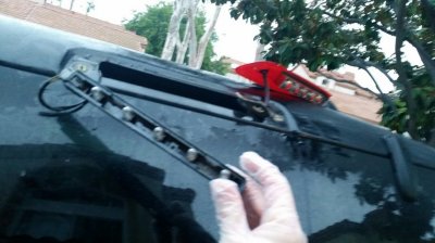

JDM Astar LEDs that work for interior and license plate lights and backups also work here
You need 5 of em though, so buy a second 10-pack if you're doing the lot of em folks
On a side note, the pathetic excuse for waterproofing insulation here really sucks
