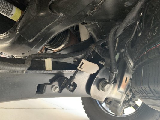

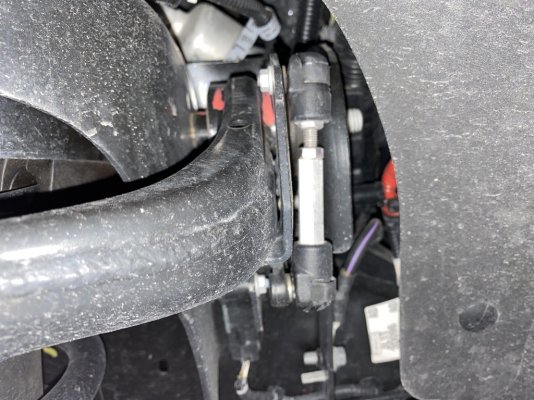

I have a lifted platinum with 35’s. Swapping the shocks around gives the wires room and the links are easy to change. A guy on this forum sells them on eBay. You need to take the sensor measurements before you lift it and adjust the new rods to match. I had mine on without the rods and measured a new one on the lot. The rear was roughly .5” longer and the front was .5” shorter if I remember right. One sensor is pushing and one pulling. Depending on your wheel offset and tire choice you may need to trim your steps and fenders.

So armed with this knowledge I now get it--the Traxda kit will soon allow this same install but without the need for the adjustable links per my understanding. Instead of needing longer/shorter links they have new brackets to make the lengths correct. You will still need to swap the shocks from side to side to create the correct clocking for the wiring.

I am going to wait on Traxda for a bit, then if that does not come around I will grab the links. I think my dealer is more comfortable with the bracket solution vs the link solution at this time for some reason. When in reality they accomplish the same exact end result.....I received this warning: "if the lift causes a failure then its not covered by any warranty." Okay guys....makes sense. Not really but OK! ;)

I drove around on my lifted Platinum for almost 4,000 miles without the extended links. I can not tell a difference in ride quality or performance after adding the links. The sensors have plenty of travel so you will not break them or the brackets. Relocating the sensors would be a huge pain and extra brackets and bolts to maintain. Just go look at them. I bet the other guys don’t make the bracket in the end. To complicated for a small sales market.

I had the dealer check for error codes without the links and there was none. Your shocks will be in a different valving setting without the links. But I couldn’t tell the difference with the lift and 35’s. Maybe on stock 22’s you could. I need to see if Lokiwolf knows if there is a Forscan code anywhere you can look at that sensor or read data from it. That is crazy they are making the brackets. You can make the links yourself if you had to. Just by going to the hardware store. Cutting, bending, drilling and powder coating the bracket must be worth it to them to say it works on a CCD Expy.
