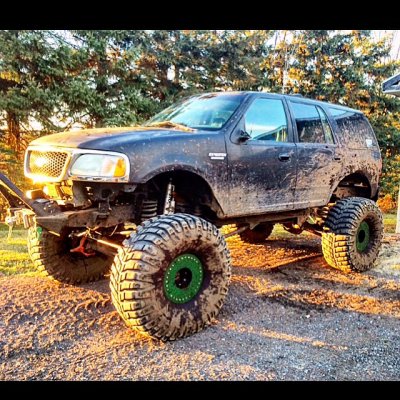

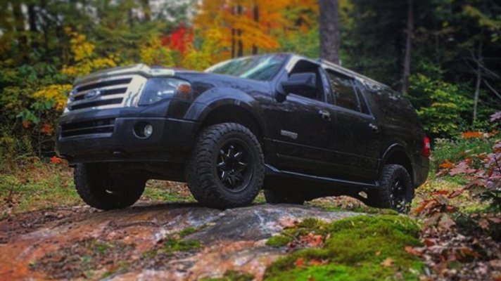

Been waiting a while to get into the club.....
Here is mine:
Before:
After:

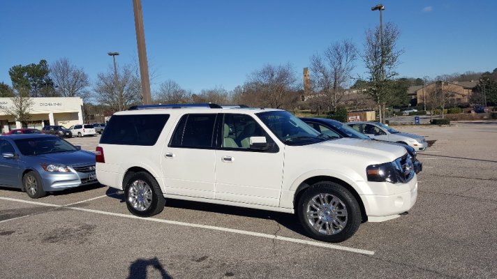

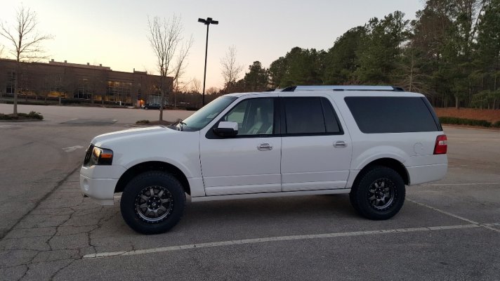

2013 Expedition EL Limited- Truxx 2.75/2 lift, 18x9 Fuel Trophy, 285/65/18 Hankook Dynapro ATM

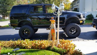

Shoot I didn't even notice you have out /15" wheels lol... Yeah the brakes are way too big to go anything less than 17... I'm pretty sure I have several millimeters maybe centimeters before they are touching the inner rim on my 17s lol ....but anyways if all hopes as planned I'll post some pics of my 2006 on 35s on this thread tomorrow for you so you can see how it needs to be trimmed
Gruz7
Jul 9, 2014
1,631
259
North Smithfield, RI

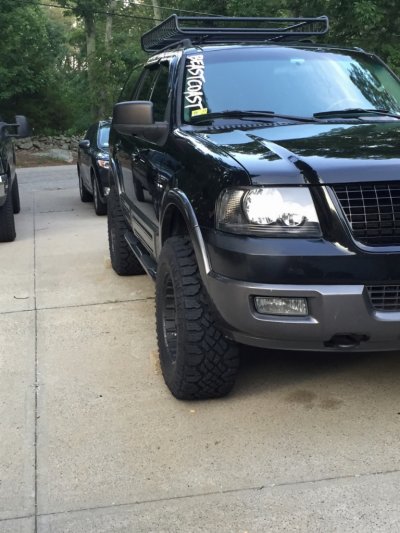

Well like I said, I'd post mine... I'm going to need to trim to trim the front valence and even the bumper a bit to get them to turn at full lock and if j really wanted to be generous I could trim the inner fender a bit too

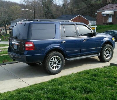

MrBlargMan
Jul 21, 2016
48
55
Colorado
Really good looking ride, Gruz7!

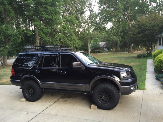

Here is a picture of my Expedition. It is on the Ebay 3.5/2.5 lift on 35x12.5x17's. 17x8.5 wheels. I had to remove the running boards and trim the lower corner of the front valance. I don't seem to be getting any inner fender rubbing on either side. There is also plenty of room between the tire and the upper control arms at full lock. And YES! I was skeptical, but it does, in fact, still fit in my garage!

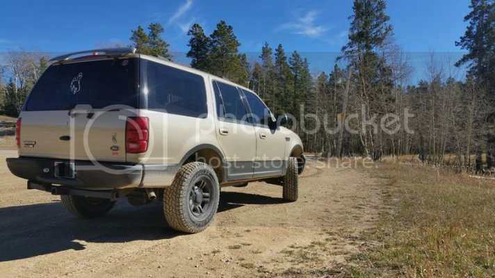

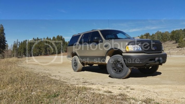

Subcanis
Mar 25, 2016
Whiskey Yankee
Got mine back on the road finally. New headgaskets, H20 pump, timing chains & tensioners, front brakes, lift (2" spacers rear, TT front), and Hercules Terra Trac AT 2 tires (285/75R16).
