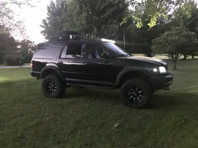

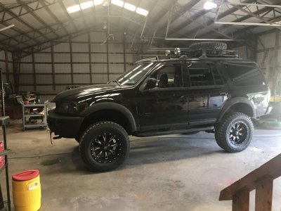

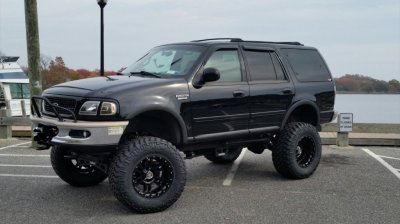

3" Body Lift
3" Torsion Keys
Coil Over Up Front
Moog Springs In Back (no spacers)
37" Toyo Open Country RT's
20" Fuel Throttle Wheels
Rough Country Winch Behind Bumper
View attachment 21295 View attachment 21296 View attachment 21297 View attachment 21298
Love it man, basically what I'm aiming for ATM.

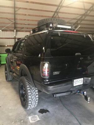

How'd you manage the hitch? All the body lifts I've seen have it sitting low looking like shit, yours looks fine.
Also how does she manage the 37's work 3.73's?
Edit: I see you answered that question already, damned phone showed only some of the new parts but not the important ones lol
Will H
Jul 27, 2017
29
16
Springfield, MO
The hitch :
On each side of the hitch where it bolts to the frame rail, there are 2 "flanges", 1 on each side, with 2 holes drilled in each. These are simply parts of the hitch that they cut and "folded" the metal over, so as the hitch gets raised up under the truck, the "flanges" hit the bottom of the frame rail and the holes align with threaded holes on the bottom of the frame rail for the bolts that attach it.
I had these "flanges" cut off flush, and re-welded 3" lower. This allowed me to raise the hitch 3 more inches up under the truck, which closed the gap between the bumper and hitch created from the body lift.
