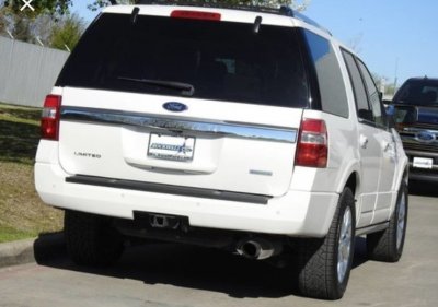

15-17 is a little more complicated, with standard length & EL have unique part numbers due to EL logo being incorporated.
FL1Z-5443400-A is an example 15-17 part number.

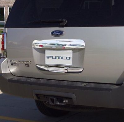

For what its worth, the 03-06 Expedition uses the same upper part as 07-14, just body colored as opposed to chrome. For those years the aftermarket has a chrome upper cover available. Heck, you can even get a matching chrome lower handle cover. Ebay/Amazon is probably your best bet. The upper cover, for example, is ebay item #130787065128

These two chrome bezels look nothing the same between 06 and 16. Not sure what you’re trying to tel him here @Flexpedition

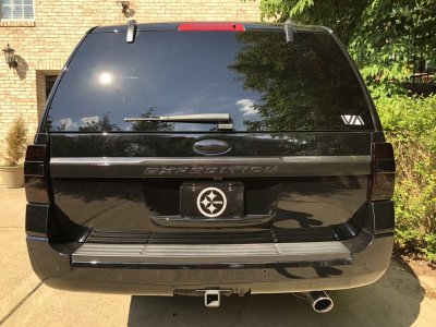

FYI, the EL on my ‘17 liftgate chrome piece were just stuck on with adhesive. I took them off the same way I debadged the rest of the liftgate.
