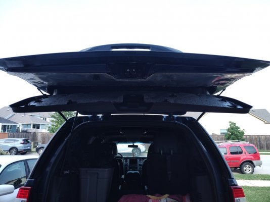

Here are photos attached.
Here I pull back as hard as I safely can to show what this plastic seems "permanently" attached to.
You can find this between the two plastic swivel screws that popped out of this same part of assembly.
In diagrams online, this is supposed to be "U" slot, that sits vertically on top of that bolt.
Instead, in this Expedition, the trim is a "O" around the bolt and because of some plastic knob on the end of that, the plastic does not fit around.
Here I just show that the rest of this f#@king thing is loose.
Because this trim is sturdy enough with the other connections to the frame, I am going to likely cut the plastic at this point and forget about it.. install it back and use tape if necessary to keep it from shaking or slapping.
Will wait in case someone has a Eureka / "you're a dummy here's why" reply.
