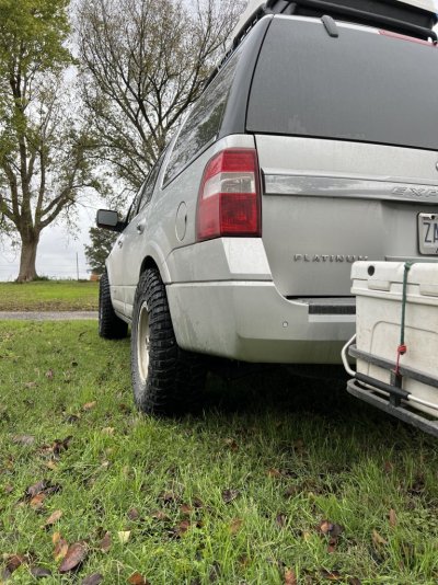

I just put on some method 17s with aggressive 0 offset and 295/70 that surprisingly fit well with very very little rub on the step. But there’s so much tire I need some lift to look better.

CCD is only the magnetic shocks - no air and no leveling. I run mine in Normal 95% of the time. Provides a smooth ride. Had a loaner Limited and it felt like mine in Comfort mode - just a bit too floaty. If somebody added an air system you should see a lot more hardware under there. Those are some aggressive looking boots you got there!!
