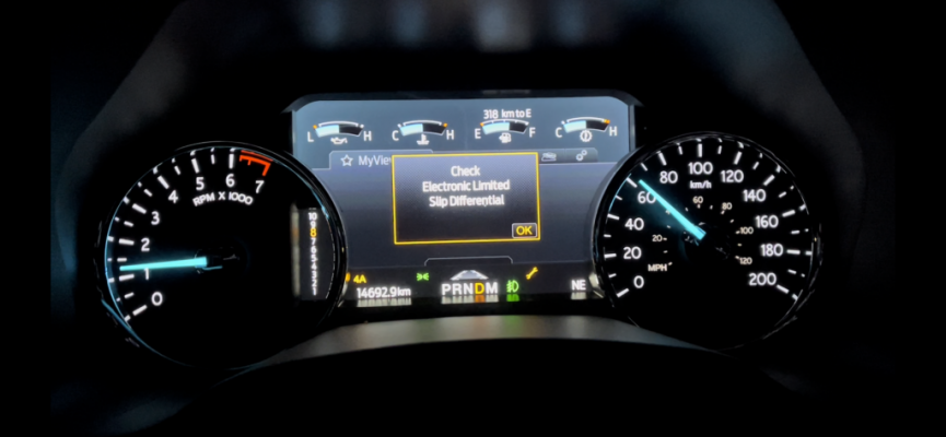

I bought Ford Expedition XLT 2021 this summer, just 15,000km. But I have a Electronic limited slip differential - Wrench warning on dash on November. I went to dealer to check and they diagnosed, they found harness issue. They replaced pig tail connector. However, I get a wrench warning about slip differential again.
Original summer tire sizes 275 65 R18, but I changed winter tire size to 275 55 R20. So I don’t know if that is a reason for a wrench warning on dash or other reason?
I still love expedition, very comfort for driving.
