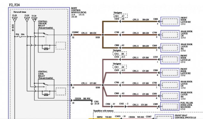

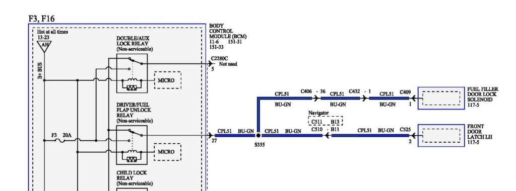

In my 2019 wiring diagram, it shows the China version has an electric lock on the gas door. If someone has a VIN number from China, you may be able to find it.
wakeboarder
Nov 16, 2019
813
471
Fort Lauderdale, FL
I don’t remember what made me say China, but i referenced it in a similar thread back in 2020.
If somebody wants to be the first to try it, this part says it fits our expeditions. it is called the Fuel Filler Door Lock Solenoid. https://www.oemfordpartsdirect.com/oem-parts/ford-fuel-filler-door-lock-actuator-ft4z6328610a
Below shows where it should be wired in.
