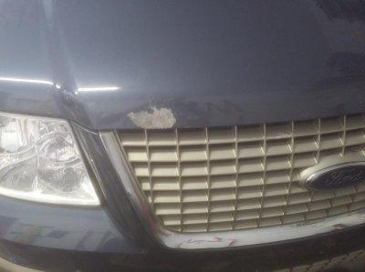

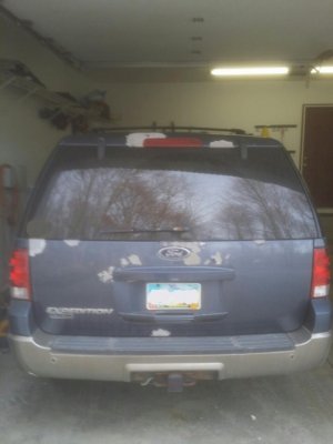

I've got a 2003 Eddie Bauer 4WD
-5.4 L (330 cid) 2 valve V8
Mine has all options EXCEPT
-Navigation
-heated seats
-traction control
-TPMS
I have never had any problems with it, except for a new catalytic converter at 135k miles.
The only thing I'd look for is paint bubbling and/or peeling. (Both of which you can see on my expedition below) however this has been determined to be a factory defect
