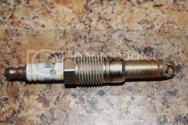

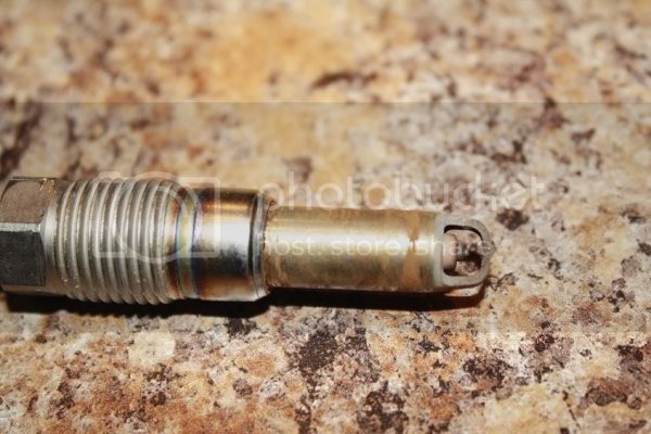

Update...replaced spark plug in cylinder #2 per yesterday's CEL. No change, plug had signs of moisture and electrode was almost non existent. Stutter and hesitation still remains. Will change out the remaining plugs and see what happens...
makindue
Jul 4, 2010
Minneapolis
Hi Reconcracer. Nice one! Can you post some photos of that newly installed spark plug? I want to know ideas of what it looks like. :D
Reconracer
Reconracer
May 31, 2010
55
Gilbert, AZ
Couple of pics of the original plug (#2 cylinder). Motorcraft Platinum. It's seen better days. Kinda funny, I went back to Checker to grab the other six plugs and the guy behind the counter got this funny look on his face. "Sir, you do know that the 2005 Expedition has EIGHT cylinders". "Yes Mr. Checker Autoparts Guy I did realize this...I bet you only have six plugs left, I've already bought the other two"...I love chasing misfire codes.
