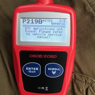

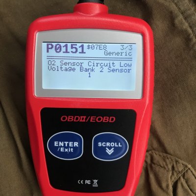

I believe there are four O2 sensors total, two on each bank, one before the CAT and another after the CAT. I recently got P0151 "O2 Sensor Circuit Low Voltage Bank 2 Sensor 1" This came up after running with P219B "Air-Fuel Ratio Imbalance Bank 2" for several weeks. I have no performance hits, either with power or MPG.

There are two O2 sensors, one for each bank? Is it likely they both go bad at the same time?
I have never had two oxygen sensors go bad at the same time (upstream or downstream) - but, if they are original or were replaced at the same time, they both could be getting weak and providing bad data, which could trip the codes.
Usually, a bad oxygen sensor will show a lean condition - not a condition.
Recently, the bank 1 front oxygen sensor was replaced in my 2015 Expedition Limited 4x4, purchased new, at 84,*** miles. It set a lean code; P0131.

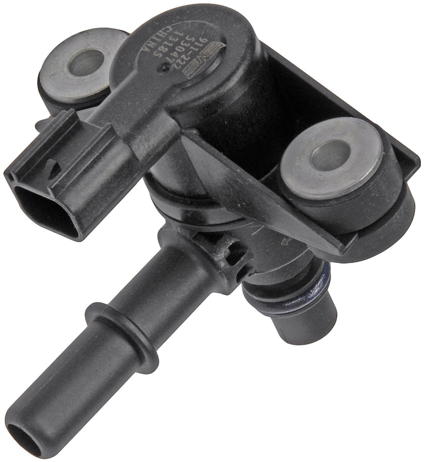

If your purge valve is stuck open - if can cause rich conditions and a rough idle. If you tend to overfill the fuel tank after the nozzle shuts off, you may have a carbon canister that is saturated with fuel and providing fuel at idle due to a stuck-open purge valve.
If your engine is running rich, both banks, and you continue to drive - it can easily damage the catalytic converters due to the rich condition.

Well I checked the purge valve last night. Using Forscan I was able to open and close the valve. I noticed that most of the time the valve was sitting around 20% open. The resistance across the valve terminals was about 22 Ohms, right within the correct range. It seemed to be functioning correctly.
