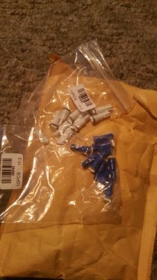

1) There's an F150 video and probably Superduty videos too... since the dash on a 3rd gen is a blend of reused F150 and Superduty solutions....
2) Amazon goes so far as to recommend a specific bulb. They're usually (although NOT always) right. I added a packet of em to an order that was short of the $35 to feee shipping and got like 60 LED bulbs (6 colors 10 ea I think?)...for like $8.99 or 12.99
Havent opened up the dash to check if their recommendation was correct yet, though.
This is what they said would fit:
