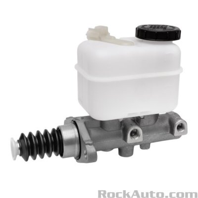

Not really. With aluminum MC bodies it isn't worth rebuilding them.
You can get a brand new one with a new reservoir for about $70 at Rock Auto.
Ford Expedition Master Cylinders at Rock Auto

Well, Rock Auto will ship world wide via FedEx or DHL. To your location it's about USD $65 . It's like us over here owning european cars. Some of the parts have to come from europe and the shipping will cost more than the part. Just the way it is.
If you have a shop locally that wants to try rebuilding it, they probably charge as much as the US shipping to do that ?
I would just suck it up and order the new MC and be confident you have a brand new brake master cylinder in your Expy. It's the heart of your brake system and you don't want to cut corners there.
